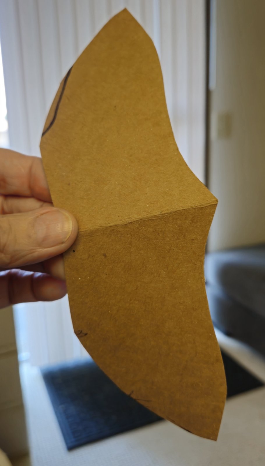

I can't find one yet for my new helmet, so I'm going to make one.

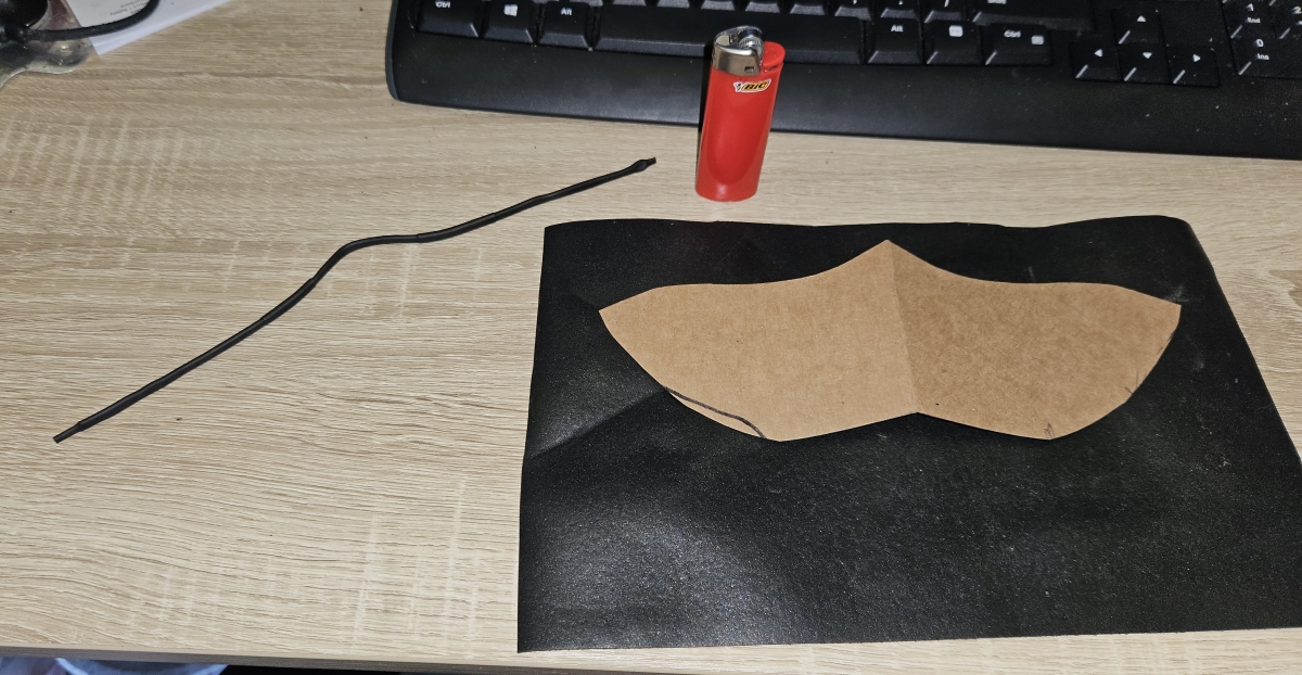

I've made a cardboard template for it, and I'm going to make it out of a nice piece of black, glove leather I picked up at my local leather supply shop years ago.
I'll update with pics after it's done.

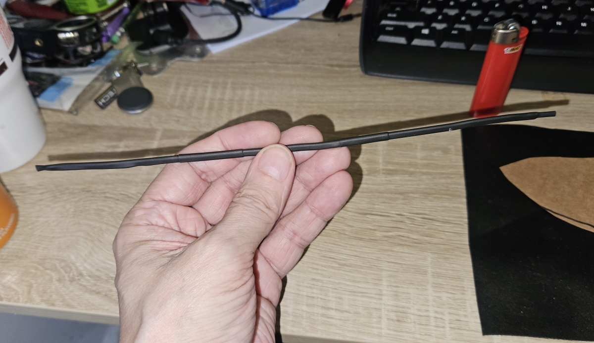

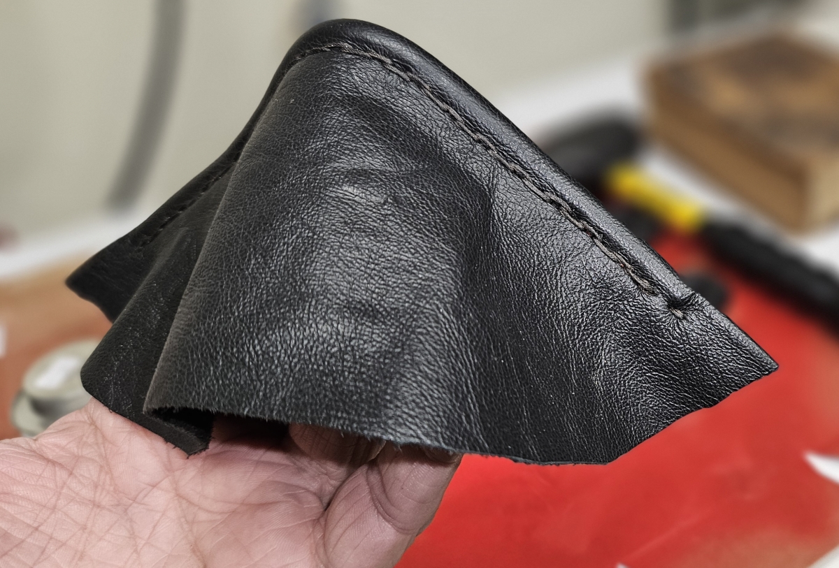

I made some progress on the breath box tonight.
The next step is the final fitment onto the upper chin bar of the helmet.

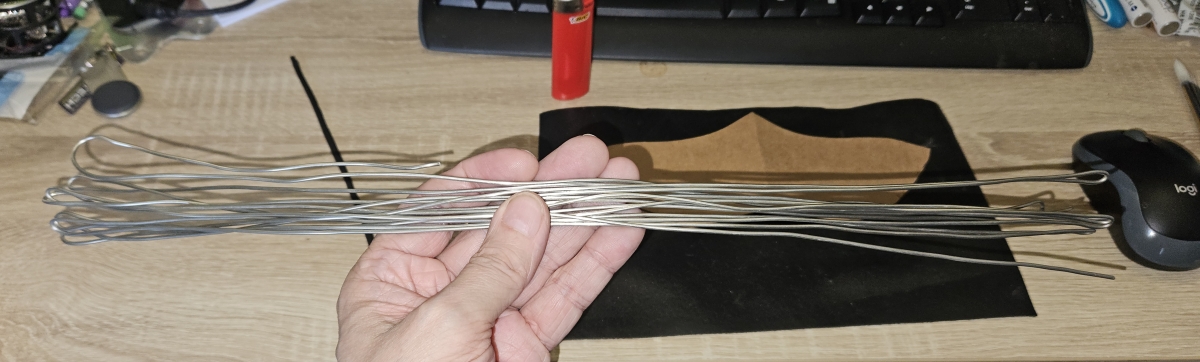

The flexible wire is just thick solder, and one strand was doubled back onto itself and then encased in black heat shrink tubing.

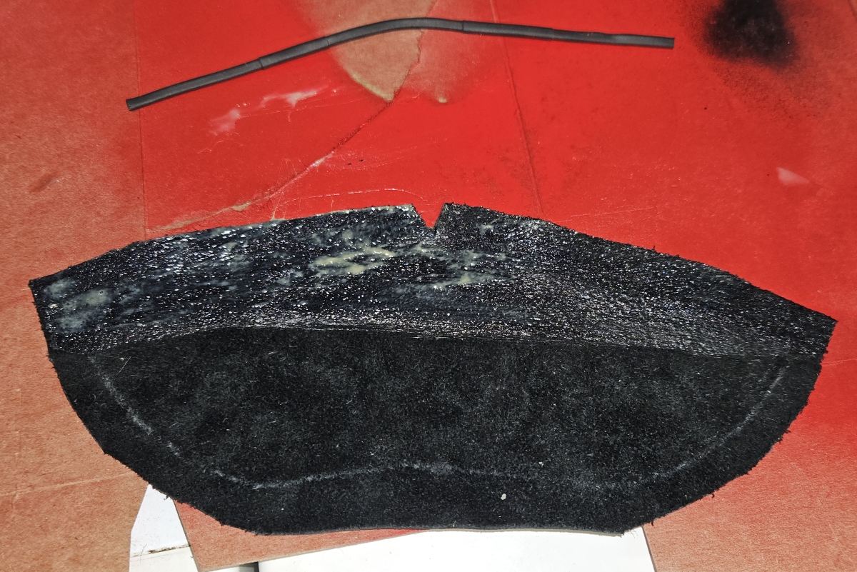

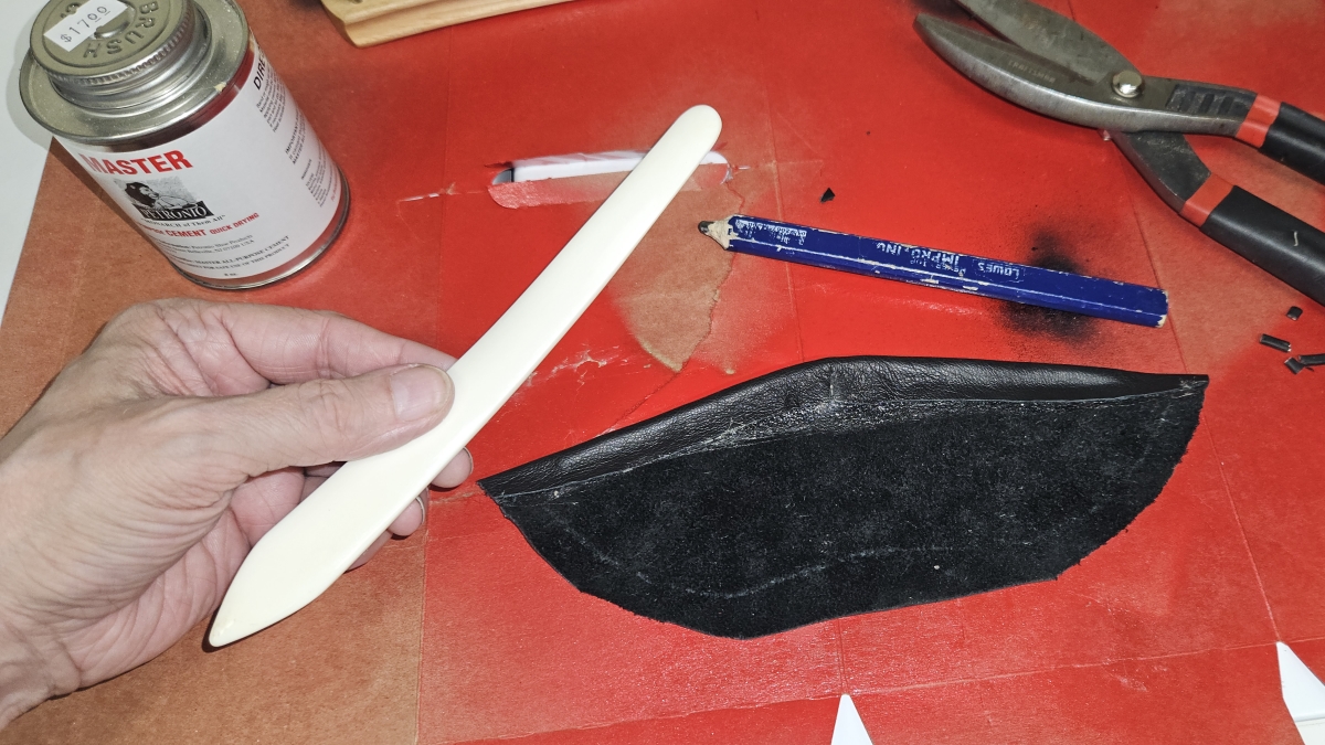

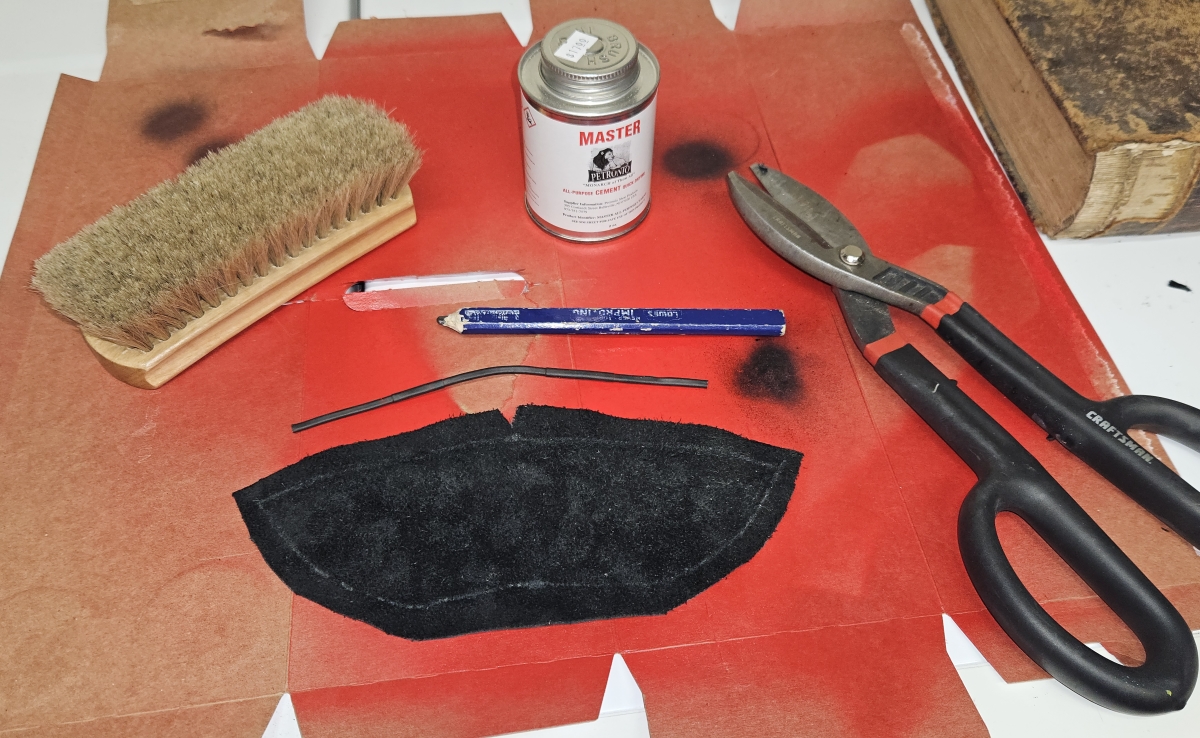

Then I cut the pattern (oversized) from some glove leather, and used cobbler's cement and rolled the top edge over the flexible metal.

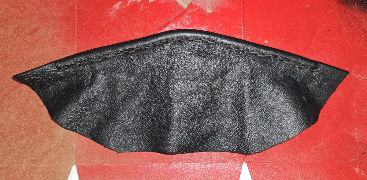

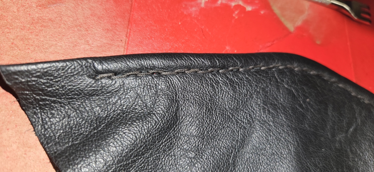

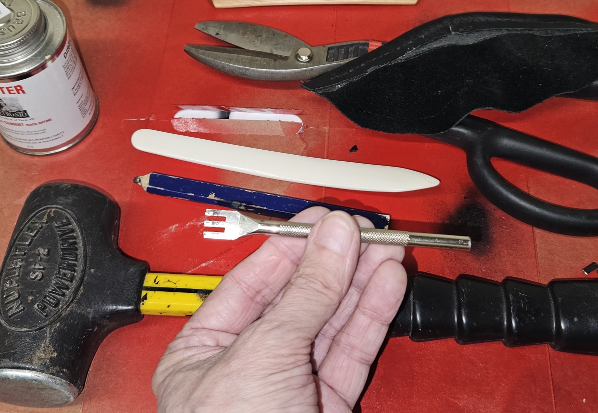

Then I used a lacing chisel to poke holes for stitching it together, and used Ritza Tiger Thread and a stair-step stitch.
*shown approximately how it will bend over the nose and cheeks when mounted in the helmet...

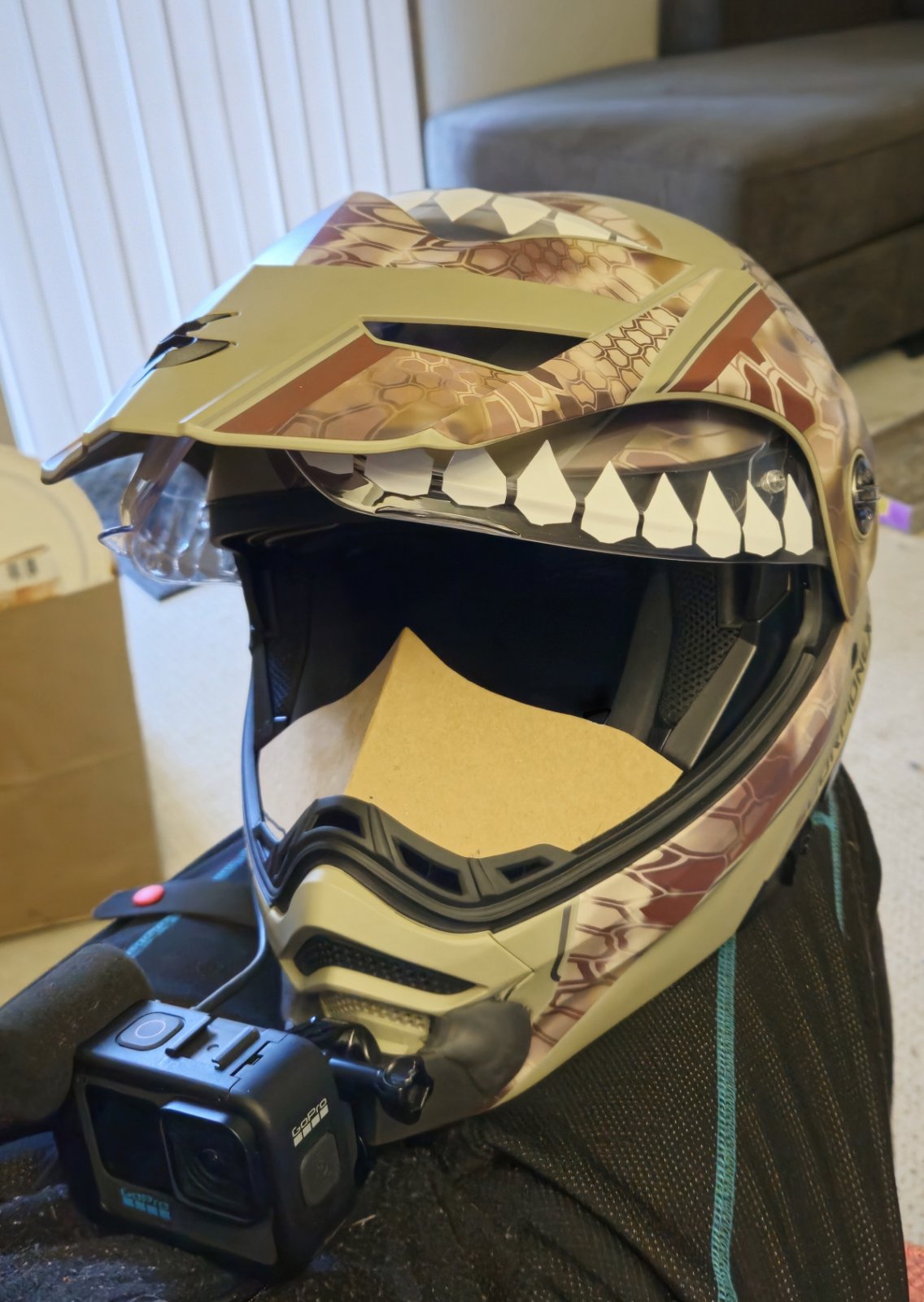

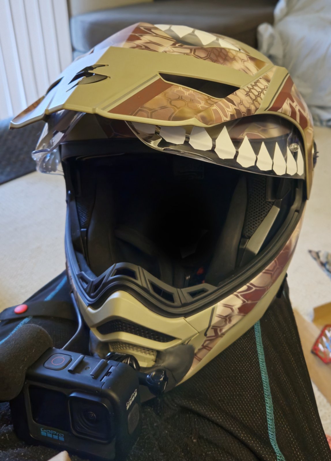

Well, now I know why Scorpion EXO didn't offer a breath box for this helmet (AT960) like they did with the previous version (AT950)...
...there is a clearance issue between the breath box membrane and the helmet when the chinbar is raised up.
There is only maybe 25mm (1-inch) of clearance, and the membrane needs to be about 60mm (2.5-inches) deep for it to hug the face across the nose & cheeks.
I was about to attach the one I'd made to the inside of the chin bar when I realized the problem.
I think the previous version of this helmet had a little bit longer face that allowed a breath mask to clear the helmet when it was opened.
So, there will be no breath mask this time, and I'll have to hope that the Sena uni-directional boom mic (for Sena 10R & 10C) that I've re-wired, to allow it to be plugged into the GoPro Media Mod, will help reduce the wind noise in the recordings.
