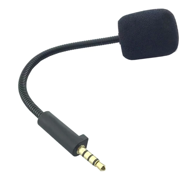

3. Yes, you can get an additional external mic (Purple Panda mentioned most often) and use this instead of splicing into the GoPro mic, but you get no direct feedback (can't hear the mic in your comms), and it's not a great solution for flip-up helmets where you are using the Cardo boom mic, not the small velcroed mic. Quality can be very good once you get mic placement correct.

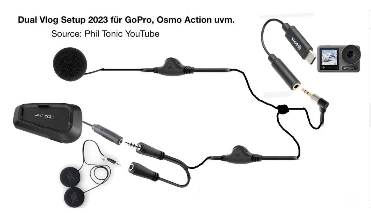

- I know many have moved from GoPro HeroXX to AcePro2, but this seems to be more for low light ability and recording times, not so much to capture good audio. Phil Tonic's setup and posts seem to confirm this as he also went with #5 with an AcePro. Phil also talks about the echo problem and suggests a solution but I haven't seen confirmation that this works 100% yet.

So there are three sources of sound - the bike, me, and the intercom speaker. I followed @LoneWolfer and his setup. In my modular helmet I have a Purple Panda near the boom for my headset. That goes into a two female to one male splitter. The other female has the mic for Røde mic that looks just like a Purple Panda but picks up much more sound. That mic is right by the speaker in the helmet. Then the male end plugs into the GoPro mic adapter that plugs into my Hero 8 or 11 or one of my other cameras.

Mic 2 - Purple Panda wired mic in the front of the right cheek pad. This feeds a sound recorder, to record my audio.
Mic 3 - Purple Panda in right ear space. This feeds to a second sound recorder, to record comms. It does also pick up my voice, which can be useful to line up with, but can be annoying if I can't get it lined up quite right.

I have a similar setup for when I record comms. Mic taped over the right speaker for comms, comms mic, and my motovlog mic. the 2 mics for recording are connected via a Y cable, but due to my half helmet, they don't overlap each other (you can't hear one from the other). Sounds pretty good, as long as I have the comms volume maxed out (which it is always).
It's a surprisingly low-tech but effective solution, IMO.
