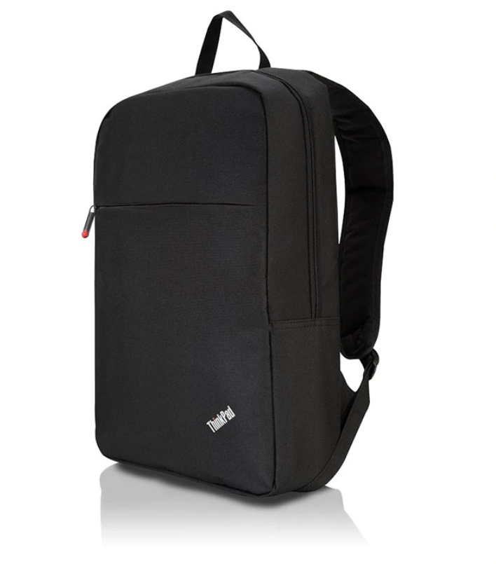

Hi,
I just got my Zoom H1n with this setup:
+ Put in a backpack (pic below)
+ Wrapped in 2 layer of towel: 1 big one filling the backpack (stop things moving around) and 1 to wrap the h1n
+ I tried both mic facing up and down
+ Input gain 4-5 (i got clipping at 6)
+ low pass off, limiter off, auto gain off
+ 24 bit 48khz
My problems:
+ I still have low frequency wind noise (which is very easy to remove in post, low pass ~200khz) -> so not a problem
+ high frequency wind noise, like the one where you are trying to blow directly into the mic, only happened at thigh speed -> I have 0 idea how to remove even with parametric EQ, and it's too tedious to go in and auto heal each second of the footage.
+ My audio result have very high dynamic range (which can be solve by compressing), but is there any other way to get optimum "gain" level with the h1n?
My questions:
+ What cause the "mid to high" frequency wind noise? As I put my recorder INSIDE towel, in a backpack? And how do I solve it?
+ Any tips for better setup?

Have you tried a different backpack? If you are getting wind noise on your back it is probably bag induced, are you not able to hide the recorder under the pillion seat?

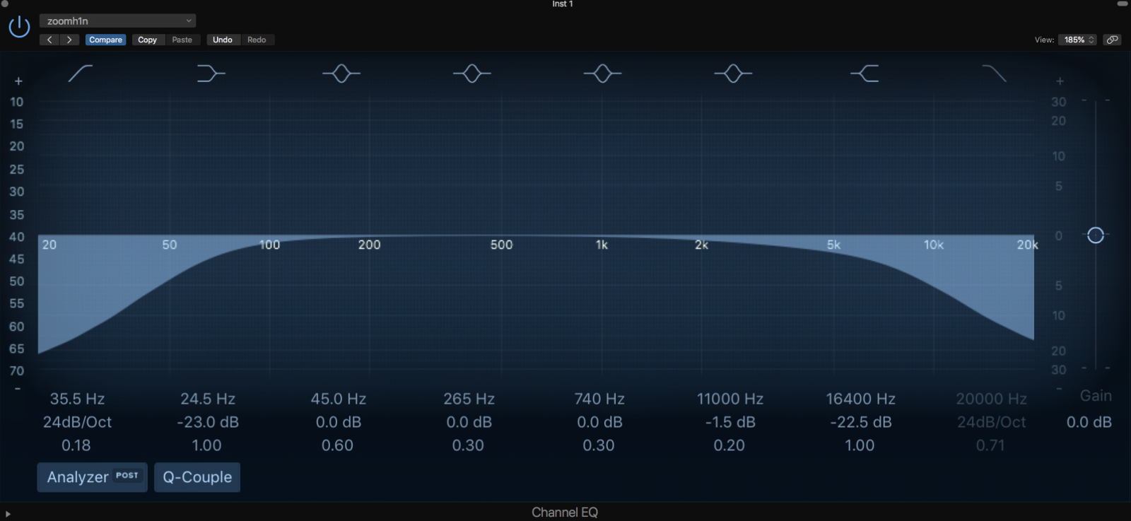

Hey Loki2W,
Hope all is good your way!
I have the zoomh1n and had similar problems. As Hippodrone said, It most likely is the back pack. The wind is hitting the backpack, creating noise and the zoom is picking it up.
I switched to a fanny pack. I started putting it on my right side, but I still had a lot of wind, I ride with it behind my back now and I get relatively little wind noise. I actually have to add it back in by mixing it with the gopros mic, it's a bit too windless.
But as you have said it does pick up frequencies in the low and high just by natural means of movement and wind. You have to do post production on the microphones. You have to go in to the EQ and lower the low frequencies and the high frequencies. I will include a picture of what mine looks like. Its basically a bell curve.
Mics are just tools, they pick everything up, you have to go in later and tell it what you want and don't. It's the same for any professional productions, music or video. Don't feel bad because you have to edit the audio, in the professional world everyone does.
As for the dynamic range, there are a few ways to fix that. The first is as you said compression. The other is to use the limiter on the zoom. Just set it to whatever you want your quietest sound to be however loud. The mic wont let it clip if you have the limiter. The problem is that the dynamic range of motorcycles is too great. You'll either have to set your loudest noise to an acceptable range but lose out on the quieter noises, or you set the quieter noises at the expense of really loud. It would be perfect if we could adjust the volume input on the fly, but because it's in a backpack, we don't have that luxury. The limiter on the zoom basically acts like a compressor and keeps all of the sounds below 0db. It sacrifices dynamic range, but it prevents clipping. The idle on my bike in my videos is almost just as loud as my bikes screams. But they don't clip. On a motorcycle it's going to be challenging getting best of both worlds.
Hope that helps,
Cheers and safe riding!
