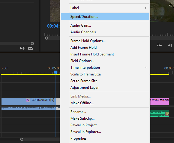

can you not split the clip at it's start and end and then copy that bit of the clip, paste it in after and right click on it to edit it?

Use the cut tool (c) to separate the bit you want slowed down from the rest. Then right click on the bit in the timeline and select "time/duration", then you type "50%" in the speed bit and boom, it also slows down/deepens the sound for added entertainment.
