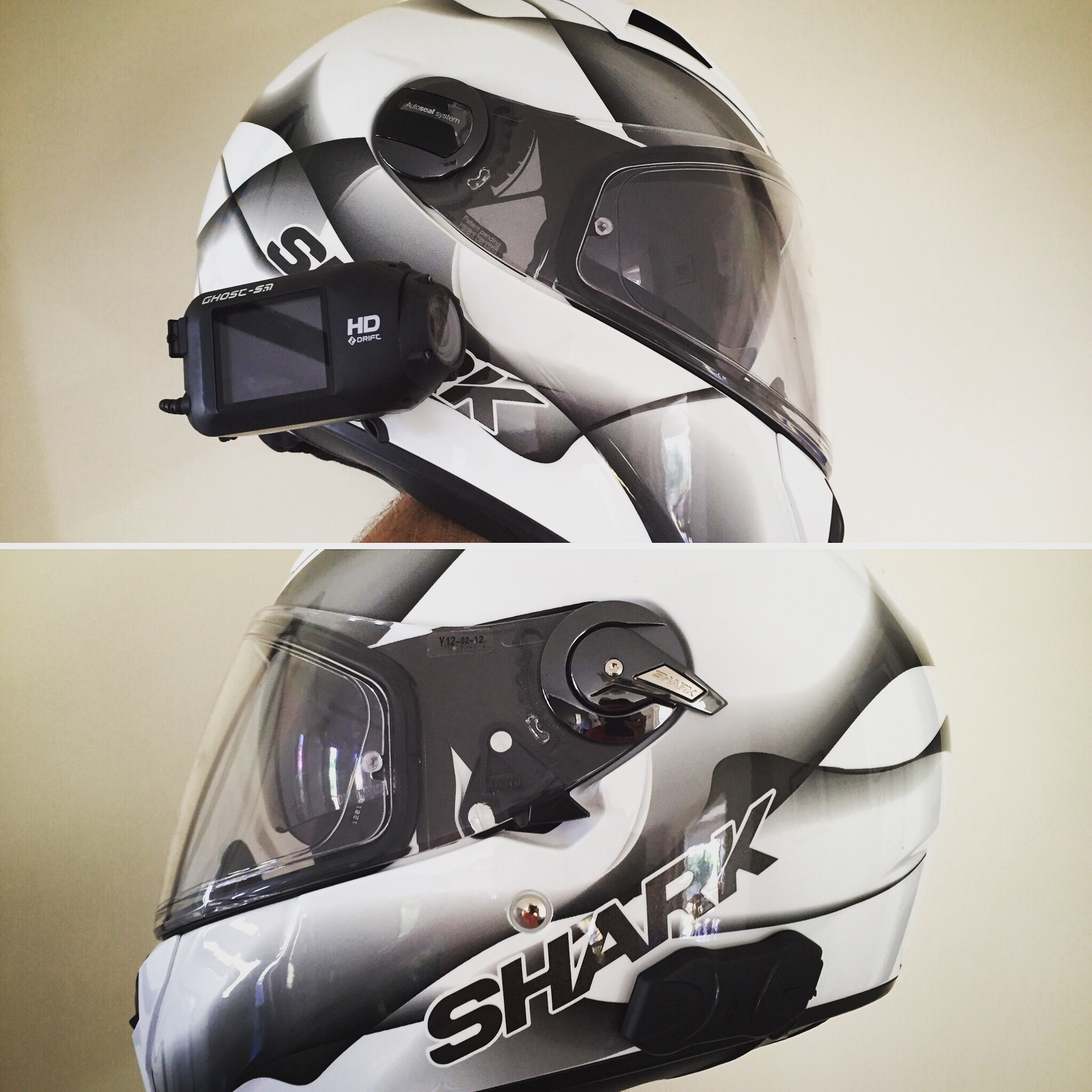

See pic.

Have you got two units or do you have a system for swapping them about?
Just the one Sena bluettoth unit, but a "clamp" on each helmet. The clamp contains the microphone, speakers and mounting point for the actual unit, which clicks on and off the clamp
Gotcha they didn't really illustrate that the boom was detachable...
My 20S came with three mic options ... the standard boom, a wired boom (short flexible lead on the end) and the wired mic. The one you use depends on your helmet or preference. I use the slim wired mic and it works great. I even bought another to hack up and use for a custom vlog mic to run to the GoPro.
