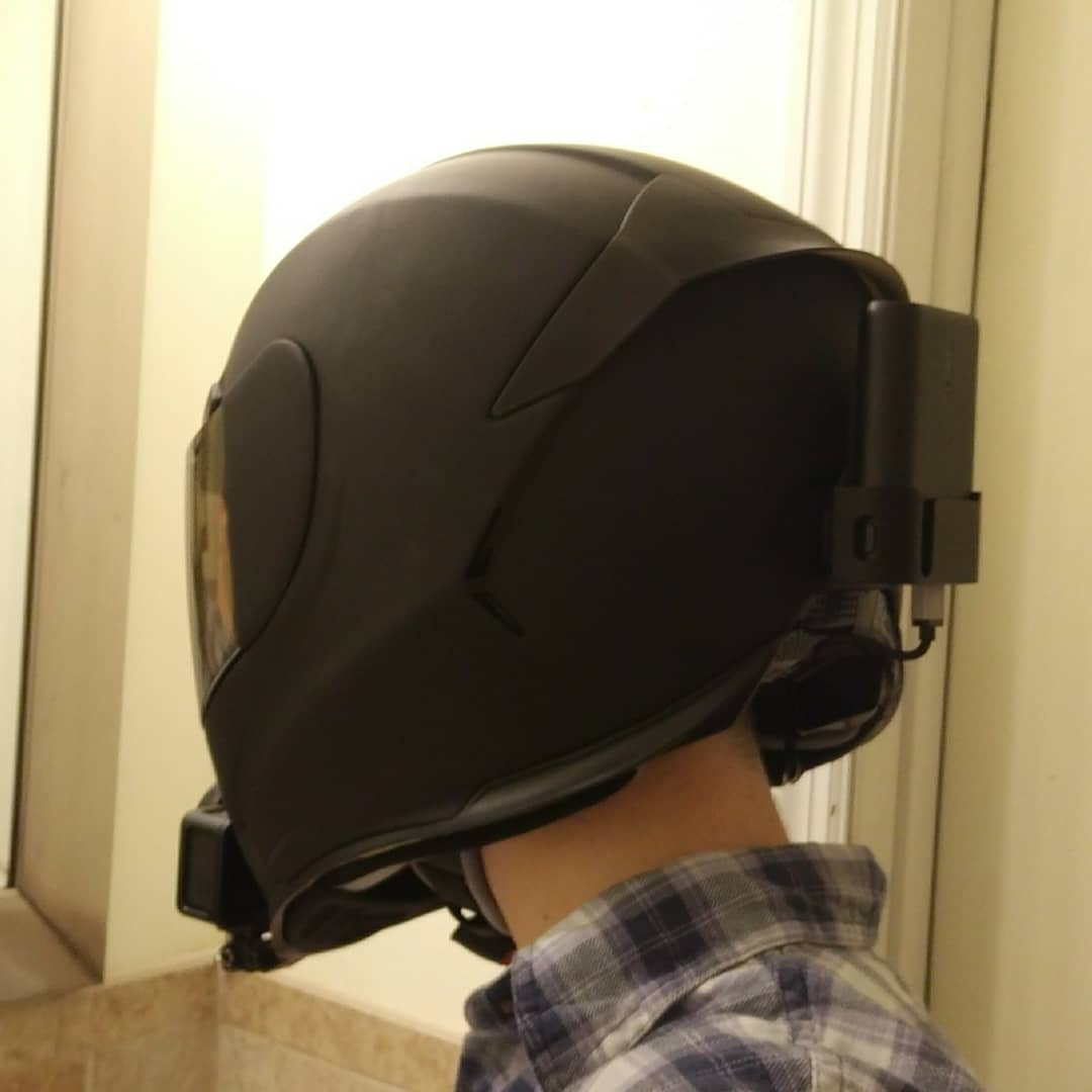

I got the helbat from helequip.com that notagrom makes, but instead of using the mounts that come with it I instead trimmed it down and used sugru to stick it to the back of my helmet.

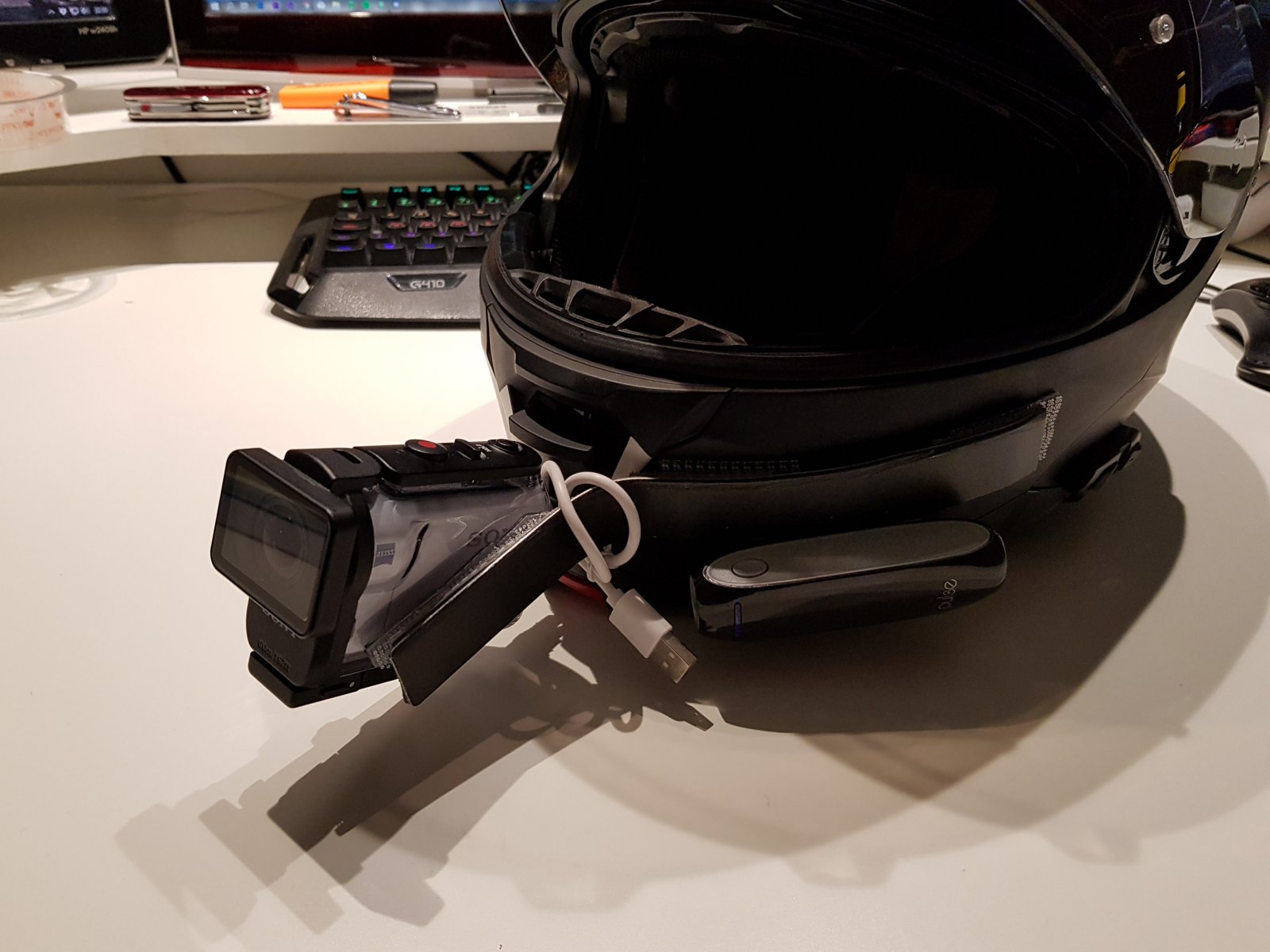

I was thinking about adding an 8000mAh powerbank on the back of my helmet, but that looked awful and obnoxious. I now have a smaller powerbank with 2000mAh, which is good enough for extending the battery life times 2.
I glued the micro USB cable into the case so it is just a plug n play instead of fiddling with the connector and potentially breaking it.
It looks ghetto, but it is the safest way to mount the cam since it's only mounted with 3M Dual-Lock which lets loose easily with a hard impact, but stays put in the wind.
