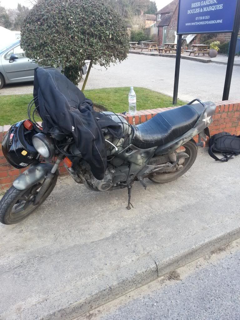

The Medic (CB500, My bike) wouldn't start on Monday and was just making a clicking/ticking noise. so I tried jump starting it with no luck. My local bike garage charged it for free yesterday but it cost me a days holiday at work :( got it back from them after 6 hours on charge, fitted it and it started. went for a 40 mile ride, came home. Then tried to start it and it worked no problem.
This morning just leaving for work, it was about 2 degrees celcius where I am, go to start the bike choke open on its sweet spot, the engine just turned over :( then ulitmately no more whirring and the annoying clicking/ticking noise began again. managed to jump start it. got halfway to work and it just cut out. nothing. No electric start and it was flat ground so didn't want to knacker myself out after pushing it up a hill four times in the morning trying to get it going.
True, I would say get a new battery but keep the other one on charge ready for the day on which it may happen again. I Originally thought it would be spark plugs but my local garage told me it was either the battery was dead or it is the starter solanoid. Either way the battery will probably need replacing. Good way of knowing is just to keep trying the ignition and when you start hearing the clicking give the horn a quick tap and if it doesnt sound as it normally is it is most likely the battery.
The below was me being stuck for an hour waiting for my boss to come and pick me up, the convenience of breaking down outside of a corner shop is that I had a warm steak slice while I waited :)
