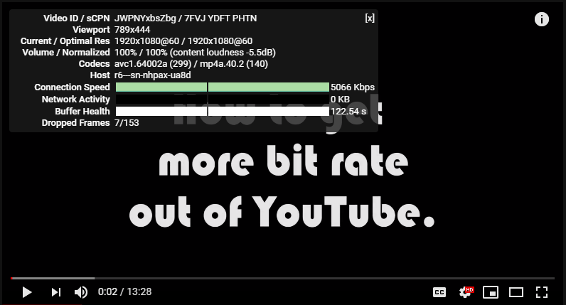

Hope it's OK I'm bringing this up, but I would like to take a more technical approach for this matter.
consensuses:
  • The higher the bitrate of the video, the better
  • The higher resolution* and frame rate, the better
  • codec we prefer in ascending order: H264 (AVC1) -> VP9 -> AV1
Just so we are clear about what is what:
1920x1080p = FHD
2560x1440p = 2K
3840x2160p = 4K
7680x4320p = 8K

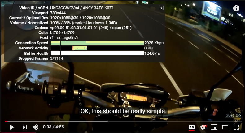

Test method:
In order the help us compare the quality without being subjected to personal preference and eyesight
in each video, just right click it the then go to "Stats for nerds"
The baseline for all videos is AVC1.
From romers, if your average video gets about 500-1000 views, you videos will be re-encoded in VP9 instead of AVC1.
(as far as I can see, I qualify and as a result my videos are re-encoded in VP9 automatically, no matter the original resolution)
If you don't have enough views, another way to "force" YouTube into re-encoding with VP9 is by uploading in 1440P instead of 1080P
In the past, if you would use the YouTube editor, enhance a video, and just trim 1 sec of the end of it just as you finish upload it to YouTube servers, It will be re-encoded in VP9 instead of AVC1.
This method no longer works.
AVC1 codec at 1080P60FPS:
VP9 codec at 1080P:
VP9 codec at 1440P:

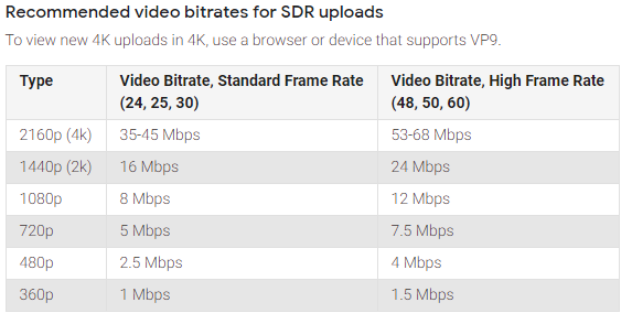

What are the limitations of AVC1?
easy, see the YouTube official page: Link
Here we get out first hint about VP9 option, but more on that later.
With this info, we can determine how to set out render options.
for example, if I upload a 1080P video at 30 FPS with 30 Mbps, it would be a total waste! as YouTube will just re-encode it without our precious bitrate data.

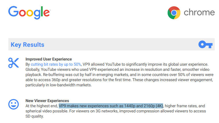

What are the limitations of VP9?
unlike previously mentioned, VP9 isn't used just for 4K, but also in 2K
Case Study: YouTube and HTML5 Video (page 2)
so, what are the limitations?
well, YouTube doesn't tell us....
But Google does!
VP9 is an open and royalty-free video coding format developed by Google, and as such, we can read more about it in here:
https://developers.google.com/media/vp9

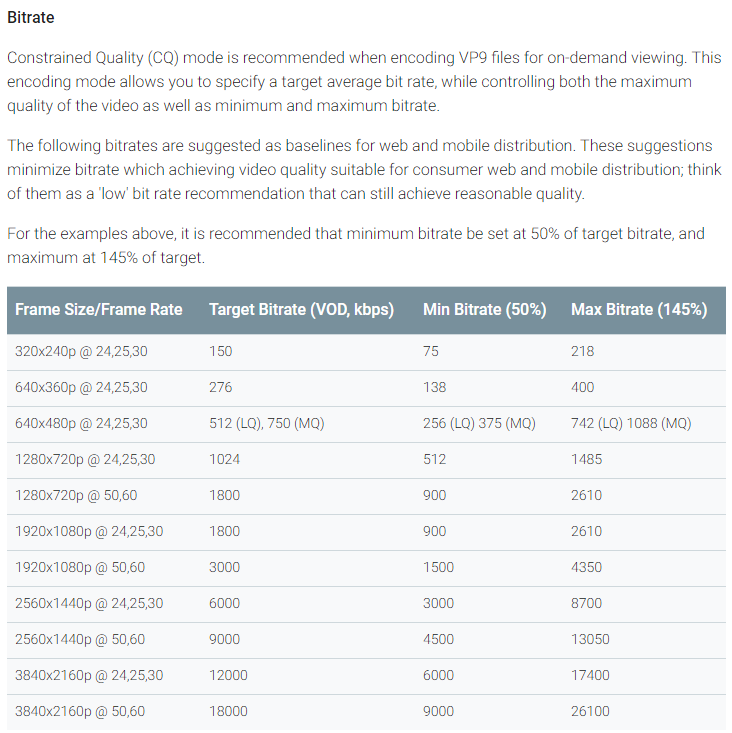

here is a snip of info about bitrate in VP9:
So what does it tells us?
Well, a lot!
with a bit of MS-Excel power, it will look like this:
* all number are in Megabyte per second, not Megabit per second.

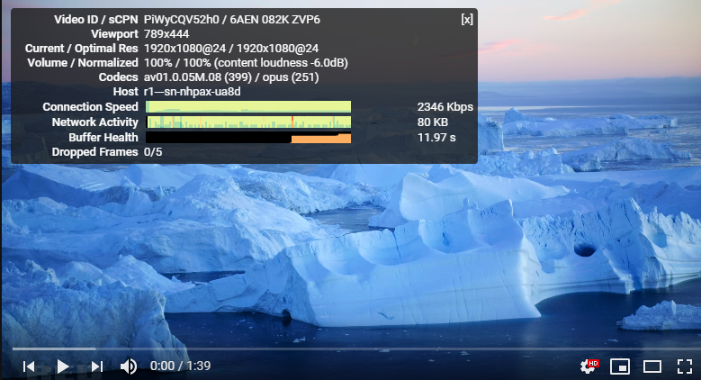

What about AV1?
AV1 is everything good with VP9, now better!

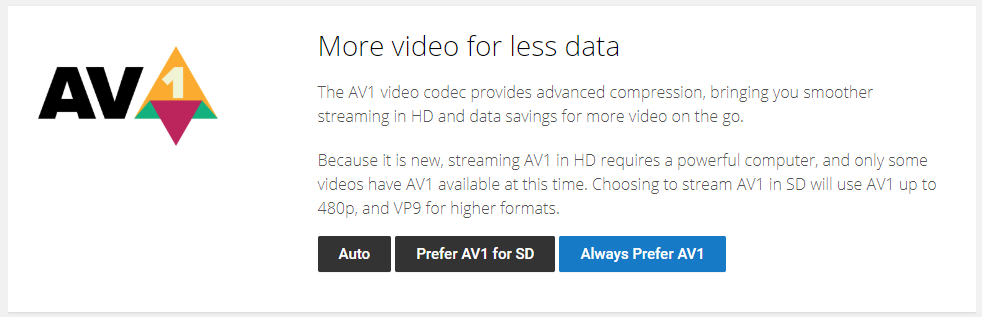

YouTube is experimenting with it,
if you want to take in on the action, on your desktop
use Chrome V70 and above
go to: chrome://flags/#enable-av1-decoder and set is to Enabled
Go to TestTube and set AV for SD or Always AV1:
and try out this playlist:
https://www.youtube.com/playlist?list=PLyqf6gJt7KuHBmeVzZteZUlNUQAVLwrZS
don't forget to right click on the video and then go to "stats for nerds" to make sure you get AV1

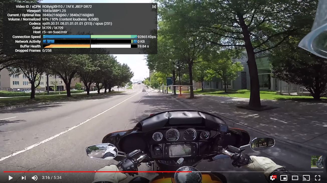

@SM26 great research. Thanks for using my topic video as an example!
What is neat is how the example video for the 4k rendering in that video's description shows the vp09 and they both have about the same number of views.
I love watching the buffer health in the stats for nerds.

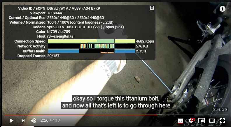

Are you able to show that with a screen grab @R-Rated?
@R-Rated
from what I can see, your 1080P videos get re-encoded in AVC1.
so for you, It make sense to render at 1440P, So you'll get the VP9 codec.
But I don't see a benefit to render it in 4K.
If I were you, I'll choose my render setting based on the Bitrate from the camera.
Personally, my main camera is Sena 10C, which output 1080P@30FPS with ~12 Megabyte per second.
So in my case, YouTube will always re-encode it to VP9 to save bandwidth,
I would use 1440P render setting only if the original footage has ~25 MB/s.
My hypothesis says that any less than this, will be indistinguishable in the output.
but I might be wrong.
@SM26 and @HippoDrone the Hero4 silver at 1080p60 has 29 Mb/s. At least that is what the data is showing on a couple of short clips on cloudy days when I pull it up the info via GoPro Quik.
From the chart from YouTube, it would appear that even at 1440, it loses 5 Mbps.
Still all of this is great info to know especially the buffer health. That would be on the viewer. Which is why we cannot always predict what the audience will experience.
