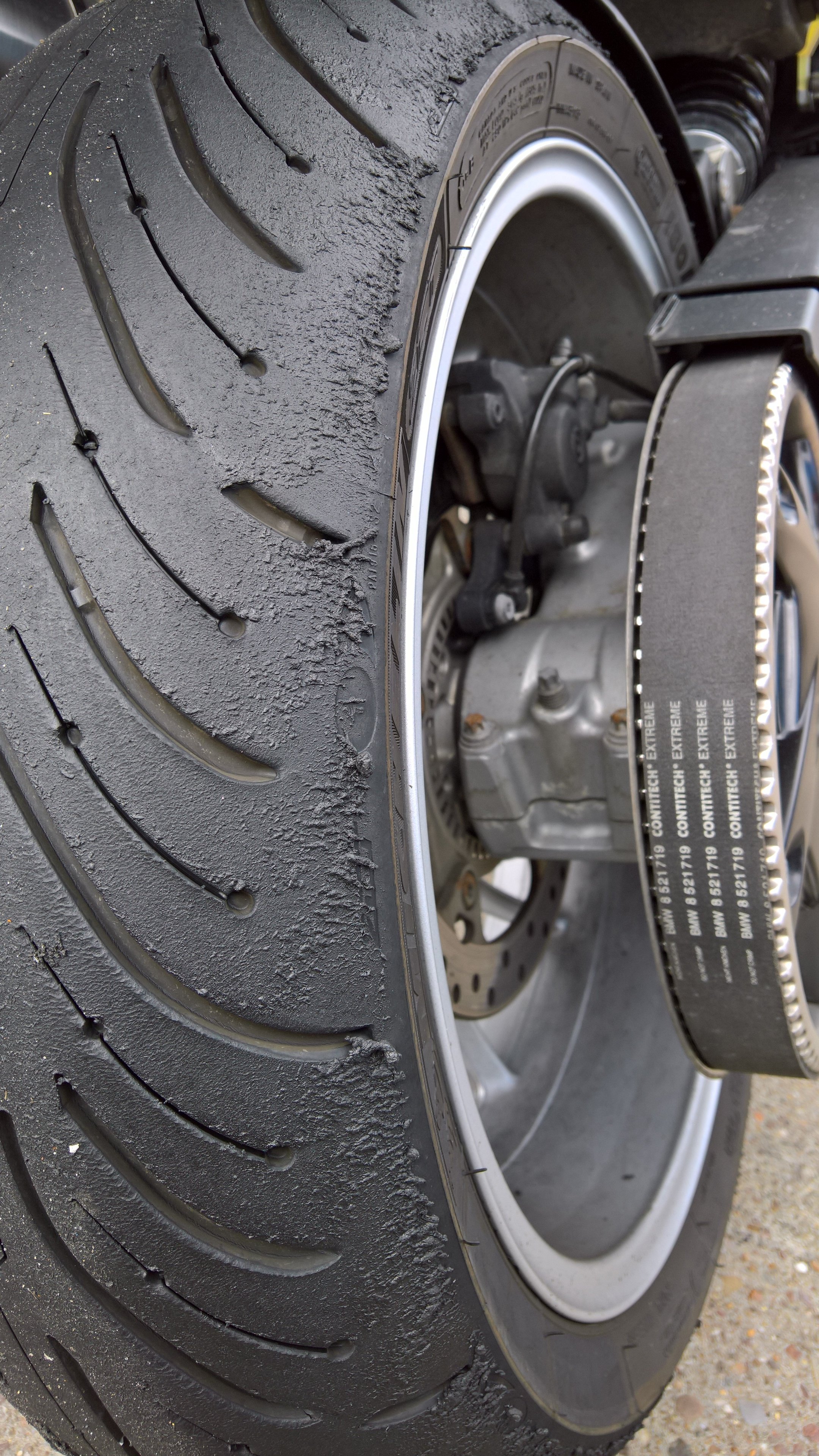

Have you still got the extensions under your pegs? I used to ride a 600 Honda Hornet and would regularly scrape my pegs. It is standard on a naked bike as these have a shorter wheel base. Its not necesarily bad and if you still have the extensions on, you still got plenty of lean left. Also check your tire for Chicken Strips, if they're all gone, then you're close to the limit. On naked bikes though, you will start having additional body parts scrape on the street before you are at the limits of the tire, the exhaust is usually an issue.

I was reading an article just recently on "chicken strips" on the outside of tyres. The opinion was that, if you are wearing the tyre right to its edge (on road conditions), you are pushing the boundaries, considering the risks of pot holes / grit gravel / etc, and wont be long before you are finding the bike sliding away beneath you (down the road). Full lean is for the track only, due to controlled conditions / ground surface.

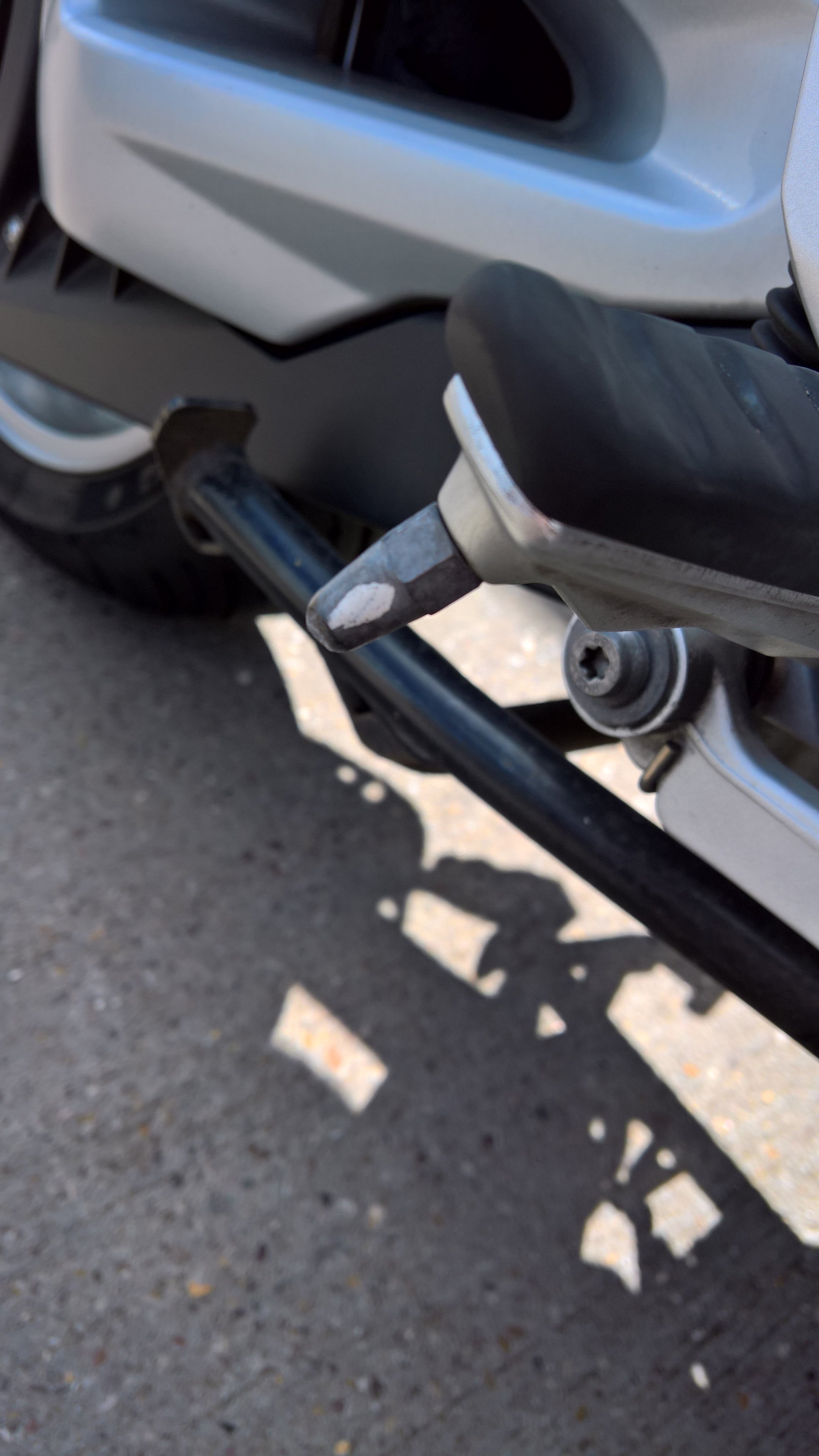

Scraping pegs is an awesome feeling.
First time I did it, i got scared too, after that, I was chasing to do it more and more.
Right one was completely ground down, left only just started.
That was on my bandit, which was a lot of fun.

The pin on the bottom of one footpeg hit the ground once, and that scared me as it's never happened before. I told my instructor and he then drilled into me how important it is to get your body leaned out.
