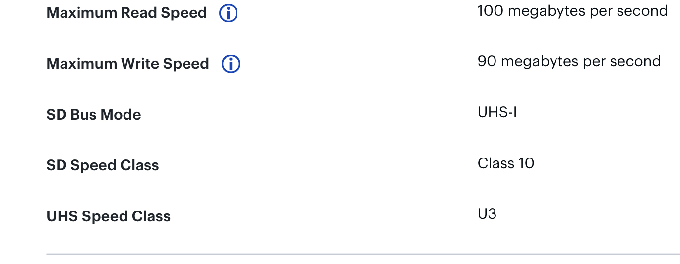

It was after bringing it into lumafusion from my SD, a lot in the community are blaming my SD saying its not fast enough to write 4K 60 footage quick enough. SIGH! apparently GoPro recommends certain SD cards for faster reading. I bought one but wont be able to try it till Monday. I should load the SD card back on my GoPro and watch the footage to see if its any different

I think the Hero 8 records 4k60 at close to 100,000 which pushes even the best of memory cards, so it does very much sound like a card speed issue

if the footage itself is jumpy it wont be savable that way, id set your camera down to 1080 till you can get a faster card for it. its never fun loosing footage, but atleast there was a bit of a leson behind it.
usually for 4k footage everone reccomends v30 spec SD cards, but you can usually get away with v10 in a pinch. not going in to the full specs of SD cards, but theres a ton of classifications on speed n everything, its worth keeping them in mind when buying new ones.

Yes lesson learned, i had no idea there was true differences and i should have. I bought the cheapest 128 i could find. I just ordered one off the recommended list and it was 3x more than i paid so it should work better.
