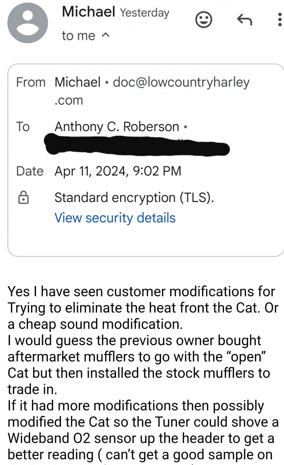

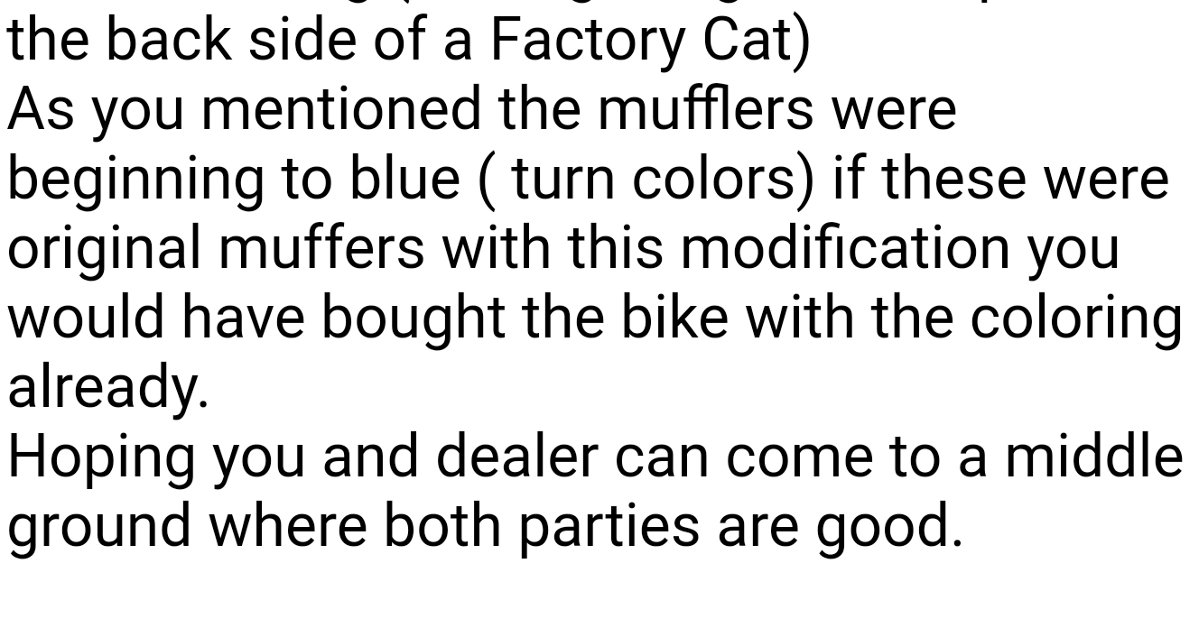

On a related note a HUGE motovlogger for repairs answered an email I sent them with the pic. I had emailed them on a whim and before I studied the footage more.
He had shared his email for questions in a video of his so I did not need to black it out here.
Tomorrow should be a good afternoon at the dealer.
Also shootout to my pal @LoneWolfer for saying the same thing as you guys. So now three sets of eyeballs have all agreed.
