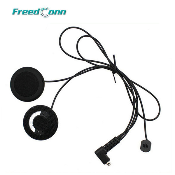

Hi guys,
I've just got myself a Freedconn intercom. Pictures below...
Think the model is called Colo. Anyway...the question is this; Here is a picture of the speakers that come with the intercom
What I want to do is turn one of the speakers into a 3.5mm plug that I can then connect into my Zoom H1 sound recorder. Basically what I want is to record my video and my own voice with my regular GoPro setup, then record the intercom conversation via the 3.5mm converted speaker... Am I explaining myself clearly?
If I just cut off one of the speakers, what wires will I be left with? a + and a - ?
Never really messed with audio wiring before, so not sure what to expect when I chop it off.
Next...if I just do this, will it just work? Do I need some inline filter, or amplifier or something?
Thanks in advance
