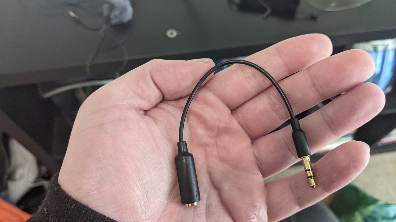

It's been a while since I used a PP with the gopro, but I recall, it had a USB adaptor, and then a short female to male adaptor that goes from 3.5mm TRRS to 3.5mm TRs, this adaptor plug should have 2 rings on it, where the PP mic has 3. You need to make sure you run both adaptors for it to work correctly.
As hippo said, but my recollection is that it was a 2 part thing and you have to run both.

OOOOOH, this might be it right here because I went straight into the adapter (I just checked a picture, I'm using the right one) but THAT would make sense. Man this thing's gonna be a mile long. Ok I'm gonna check that out when I get home for sure.
You don't want the long 6ft extension. You want the short one that looks like this.
Sorry, it is female to male, I miss typed in the first reply.

Ok so sounds like I could have 1 of any issues or even multiple issues here, I'm not sure if I plugged it in first or not. And I'm for sure not using that 2nd adapter.
Ya I didn't mean the long one but with 2 adapters plus the mic cord it's gonna be fairly long. I'll find a place to tuck it in my cheek pad or something otherwise maybe a stick on thing to clip it to....anyway that's secondary at this point.
