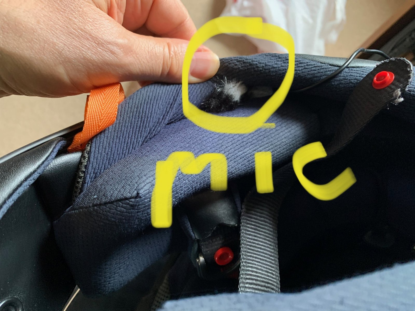

I’ve been growing my YT finance channel and thought it would be cool to talk finance while on the Harley. I have a decent Power De Wise Omni lav mic. I have an Arai Quantum X helmet. I've watched a few YT vids on mic placement but couldn’t find a spot behind the Arai cheek pad because of the helmet design. So I just tucked the mic inside a cheek pad space to test out the audio (see photo). I had the mic plugged into a Zoom H1 recorder with input set to 50% (probably too high I'm sure).
When I rode, the mic picked up too much of the Harley’s sound and my voice was muffled and too quiet. I tried with the vidor open and closed. The faster I rode the more bike noise the mic picked up. I figured I’d ask your opinion before I start buying more mic’s. Do you think this is because of the mic type or the helmet type?

Mic is too far back and has little shielding underneath. Move it forward closer to your mouth. Tape it in there to try it if necessary.
Thanks. Unfortunately, I cannot move it further forward in the padding but I will try taping it to the front of the helmet next to the padding.

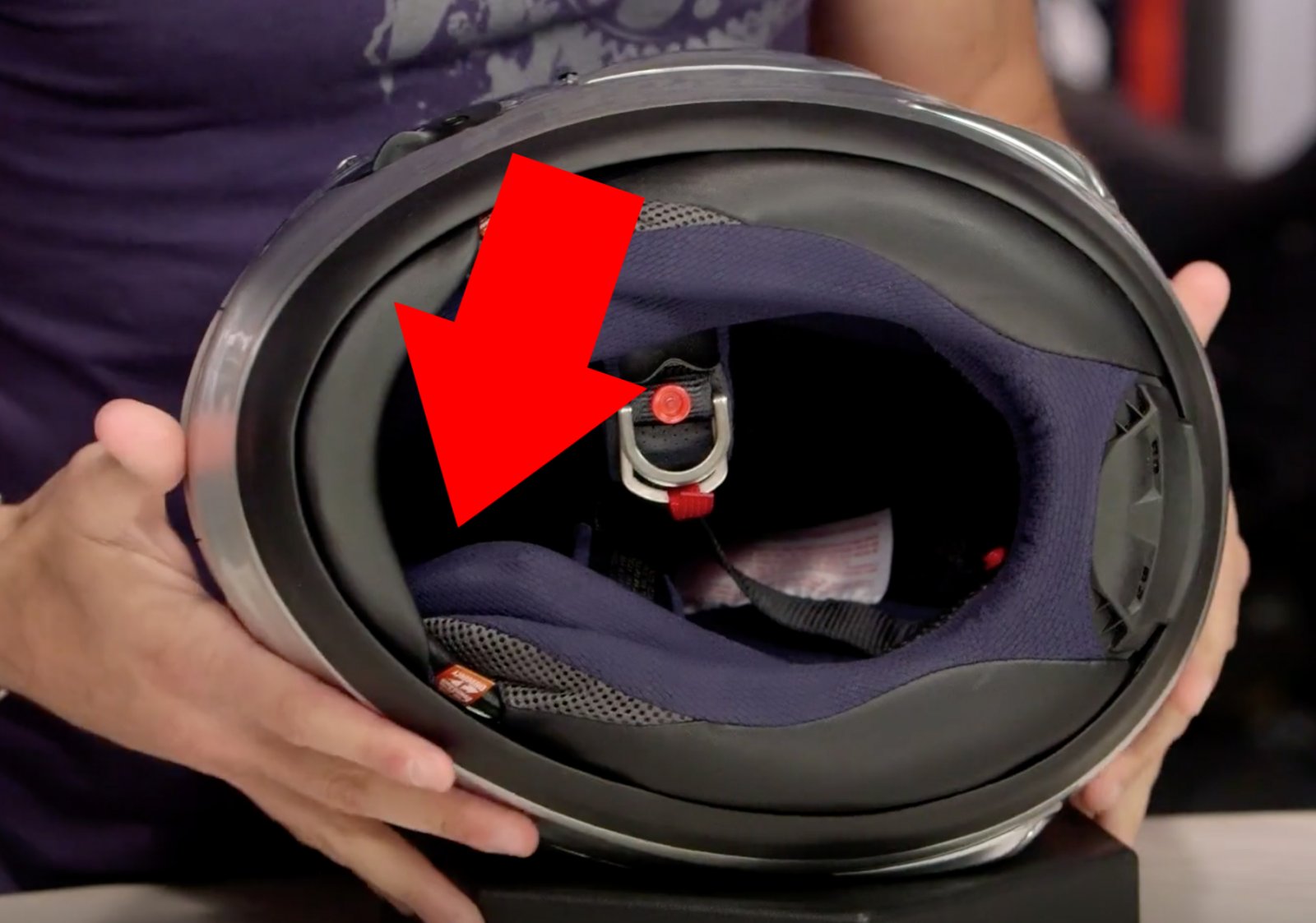

Yes, move the mic closer to your mouth, and with no contact with the lining of the inner shell.
Here is a pic of where I would look to place it in your helmet. I personally would cut a small hole right in the cheekpad at the bottom and feet the mic upinside between the outer lining of the cheek pad and the liner right in front of your mouth. This will secure it in place and remove the necessity of a wind sock since the cheek pad outerlayer will be the wind sock.
Or you can use another method to secure it to the cheek pad in fron of your mouth such as a lav mic clip, velcro or savety pin WITH a wind sock of some kind if not a few layers of them.
Also play with gain setting on the Zoom. Try about five different levels all on the same stretch of road, same words, cadance and volume to your voice and you will find the perfect setting.

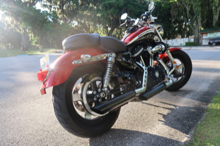

I have a 2013 Custom 1200 with some Rush 1.7
5 inch slip ons
