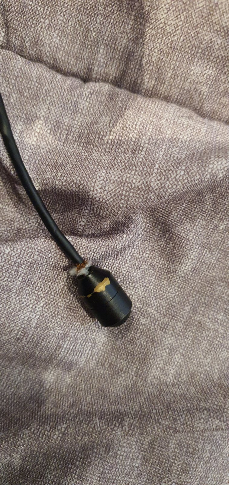

I was having issues with my lav mic and when I investigated it, it was because it was damaged.
This is the mic I bought back when it was £20. Now it's £70+!!!
https://www.amazon.co.uk/dp/B00VWCK0BE?ref=ppx_pop_mob_ap_share
It worked, but broke after 5 months. Not worth the money when it was 20. I'd not pay 70 for it.

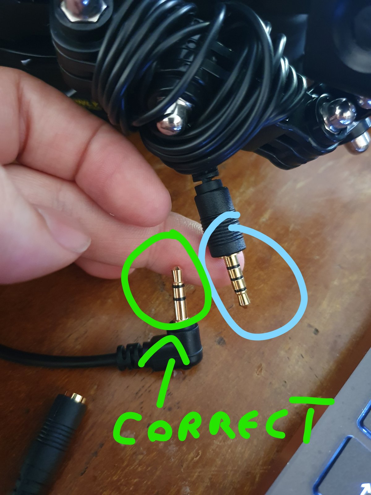

RESOLVED!
So I found the issue, I should of considered this soon as I used to be a sound engineer, but that's what happens when you trust online information.
You need to use a 2-ring 3.5mm jack
NOT a 3 ring, with the Audio Adapter (for Hero4, later adapters, I have no idea)
Photo for reference, note the black rings.

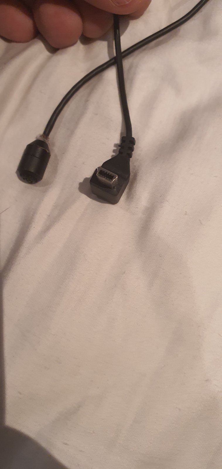

You're saying this is for the Hero4? You can get the mics with the correct plug already on them. I tried adaptors but they never worked for me.
This is the mic that broke at the other end, but it worked up until that happened.

That's certainly an option. I'm using an official goPro adapter, which works well. It's only a 4" cable (no brick like the later models need)
The non-official ones don't work normally, this is by design as goPro wants you to only use branded items. (Think it cost about £10)
