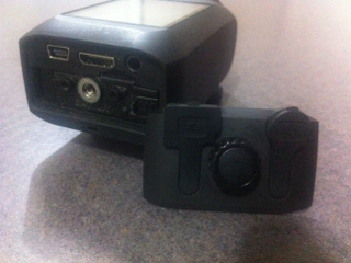

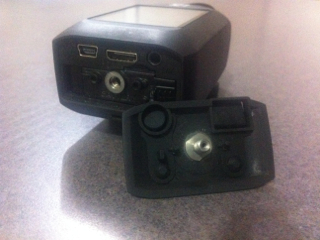

....still got the spinning screw in accessory hatch .. See couple posts up .... Anyone got an idea how to get the cover off?
Hey Janxy, are you talking about this back:
If so, then there appears to be two possible reasons why your knob spins (Porno Exorcist anybody?).
Either the black knob on the outside of the hatch has come unstuck from the bolt, or the nut has become unstuck from the door that holds the battery in.
Easy answer, send it back to Drift. But, if you don't mind getting your hands dirty...
Break the knob off with some pliers so you get to the other end of the bolt. Then undo it. If that works, yay. If not:
Its the nut that's loose in the door. Send it back to Drift.
